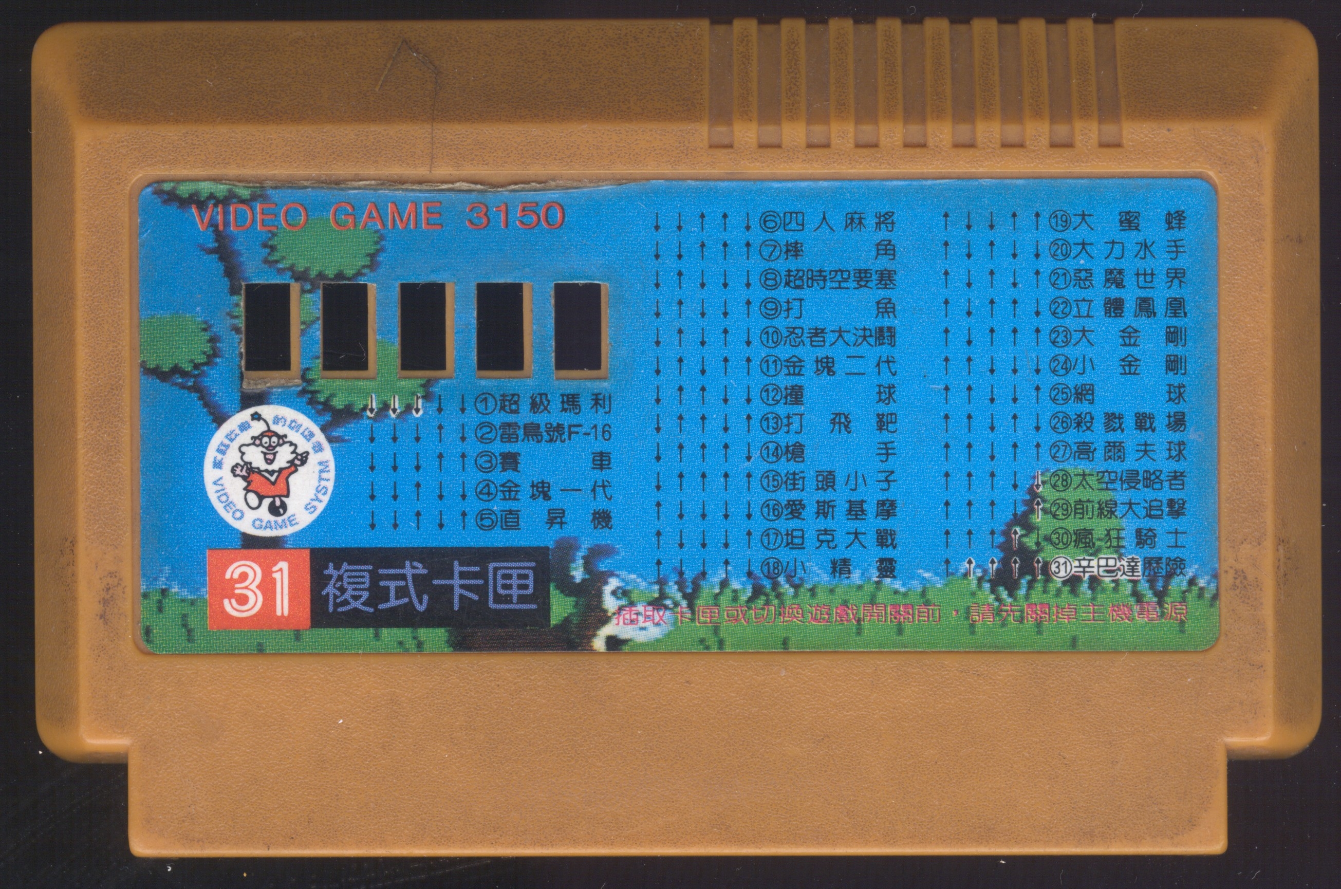

31 in 1 multi-cart with 5 switches: 31 NROM games (30 x 16K + 1 * 32K)
I bet tepple's was wondering in one of previous posts if there ever was a cartridge with switches. So yes, it was and even they did the shell
for that with factory created holes with bevels for the switches. So it was not something done in low quantity.
Switches control both PRG & CHR upper address lines and few logic gates set proper mirroring & 16/32K mode upon them.
Games: Super Mario Bros, Moby Demo, Star Force, F-1 Race, Lode Runner, Raid on Bungeling Bay, NES Tutor 101, Kinnikuman - Muscle Tag Match, Chou Jikuu Yousai, - Macross, Chack 'n Pop, Ikki, Championship Lode Runner, Lunar Ball, Duck Hunt, Wild Gunman, Urban Champion, Ice Climber, Battle City, Pac-Man, Galaxian, Popeye, Devil World, Exerion, Donkey Kong, Donkey Kong Jr., Tennis, Field Combat, Golf, Space Invaders, Front Line, Zippy Race, Super Arabian
 SW1 SW2 SW3 SW4 SW4 (top position=1, bottom position = 0)
  s   s   s   s   s
  +---+---+---+---+- select 8kB CHR
  +---+---+---+---+- select 16 kB PRG (*)
  +----------------- mirroring (0=V, 1=H)
(*) when sssss=00000/00001 -> $8000=00000, $c0000=00001
    else                   -> $8000=sssss, $c0000=sssss
