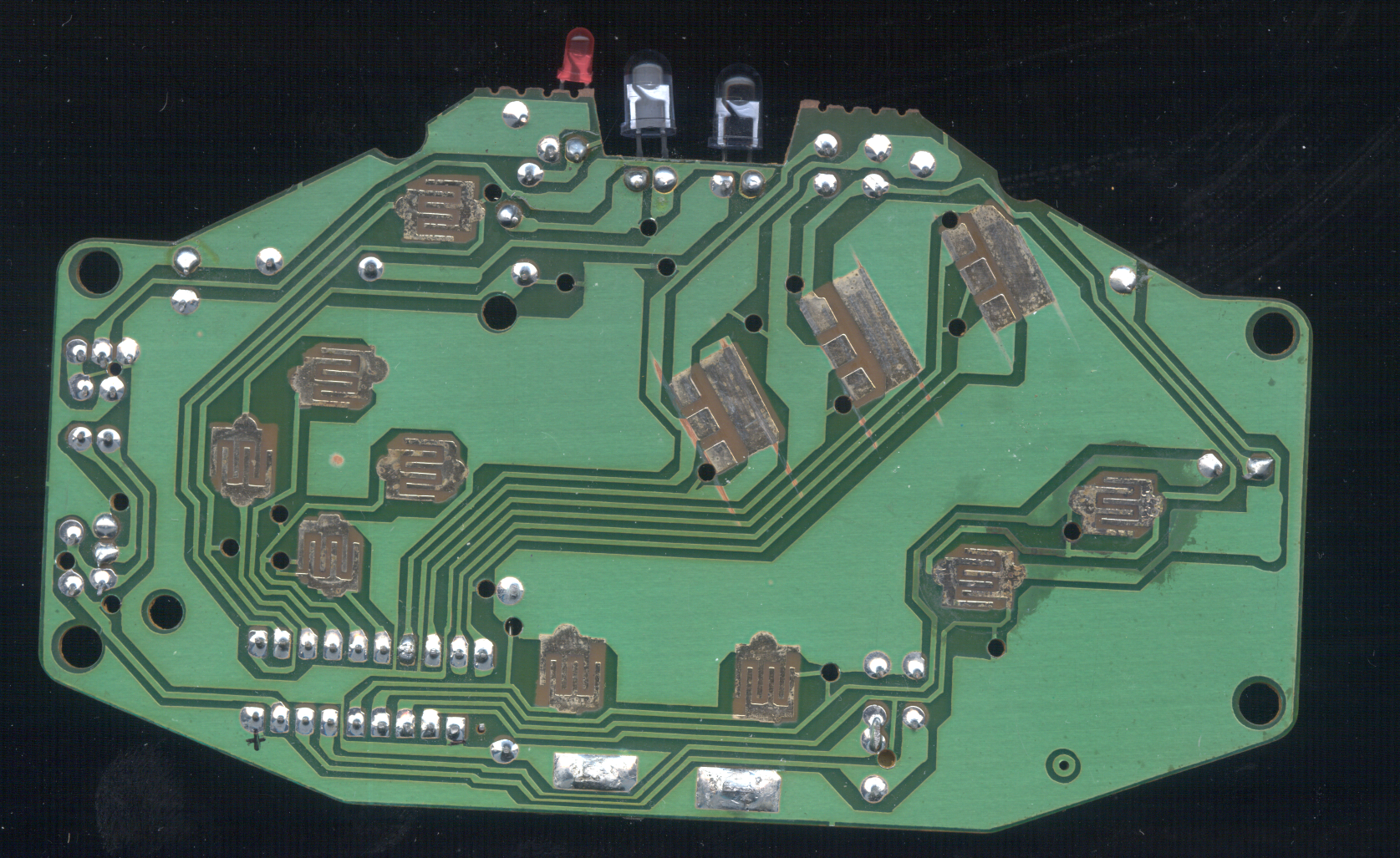

Re: [teardown] Micro Genius IQ 1000 and IQ 2000 famiclones
I finally received TIJ-309 micro genius IQ-1000 joypad so I was able to find out its protocol.
** TIJ-309 micro genius IQ-1000 joypad reverse-engineering **
The hardware of joypad consists of:
* FLY046 chip which generates:
  - modulation carrier (pin 11)
  - envelope signal (pin 12)
* FLY045 chip (which is 6x4069 inverter), which NANDs those signals and finally
drives drives infrared diodes (using PNP+NPN transister)
Warning: The timing of chip (modulation carrier, frame duration) is determined by the value of RX resistor.
I analyzed two joypads and each has different value (160k, 190k).
The description below are for 190k
When a buton is hold, the following is transmitted:
  Frame      Gap     ....
<-4675ms-><-5000ms-> ....
Each frame consist of:
XX*########
  ||||||||+- A       (Y=Pressed, X=Released)
  |||||||+-- B       (Y=Pressed, X=Released)
  ||||||+--- Select  (Y=Pressed, X=Released)
  |||||+---- Start   (Y=Pressed, X=Released)
  ||||+----- Up      (Y=Pressed, X=Released)
  |||+------ Down    (Y=Pressed, X=Released)
  ||+------- Left    (Y=Pressed, X=Released)
  |+-------- Right   (Y=Pressed, X=Released)
  +--------- X=P1, Y=P2
If turbo is hold, the state of button is toggled every 3 frames
Each bit in frame can be either
"X"
              <--------285u--------------><----140u---->
fly046 pin 11 ____________________________||||||||||||||
pin046 pin 12 ____________________________--------------
fly045 pin 8  -----------------------------------|||||||
                                                 <-77u->
"Y"
              <---140u-----><----------285u------------>
fly046 pin 11 ______________||||||||||||||||||||||||||||
pin046 pin 12 ______________----------------------------
fly045 pin 8  -------------------|||||||||||||||||||||||
                                 <---------235u-------->
where:
____ = low
---- = high
|||| = toggle at 70kHz
            ,---V---.
       !UP->|01   20|<-!DOWN
    !START->|02   19|<-!LEFt
   !SELECT->|03   18|<-!RIGHT
        !B->|04   17|<-!2P/1P
        !A->|05   16|--VCC
 !TURBO_ON->|06   15|<-!OFF/ON
     XTAL1->|07   14|--unknown input (tied to GND)
     XTAL2->|08   13|--unknown input (tied VCC)
   !REDLED<-|09   12|->IR2
       GND--|10   11|->IR1
 		FLY046 (transmitter)
!REDLED is open collector - when any of the button is pressed in transmitted frame, it goes low
