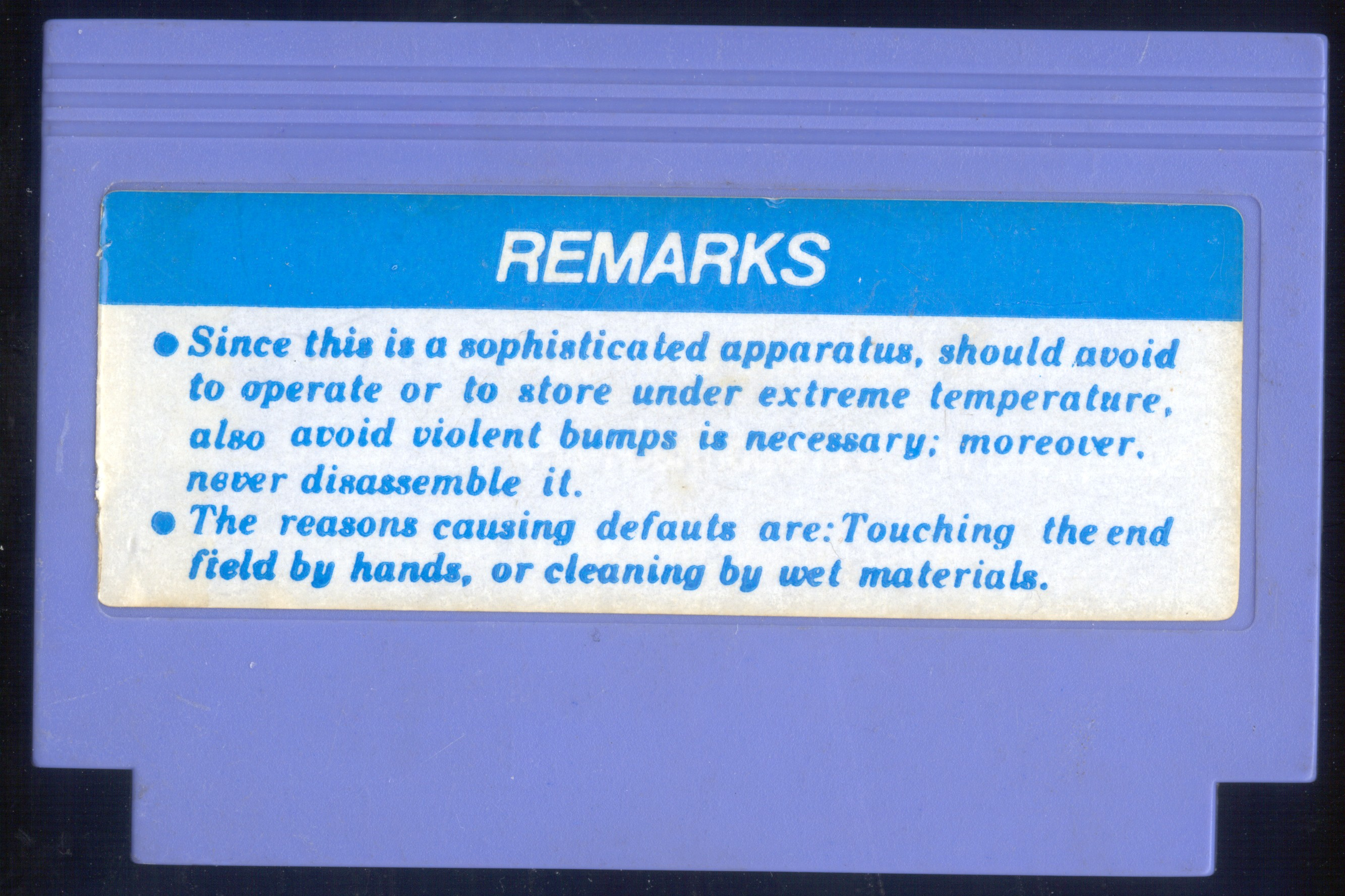

This reset-baset cartridge consists of 4 games and uses mysterious DIP40 "C5052-13" chip (and a battery backup which is rare for pirate games).
At first I thought it is MMC3 clone, but when I dumped the games, one of them turned out to be MMC1:
