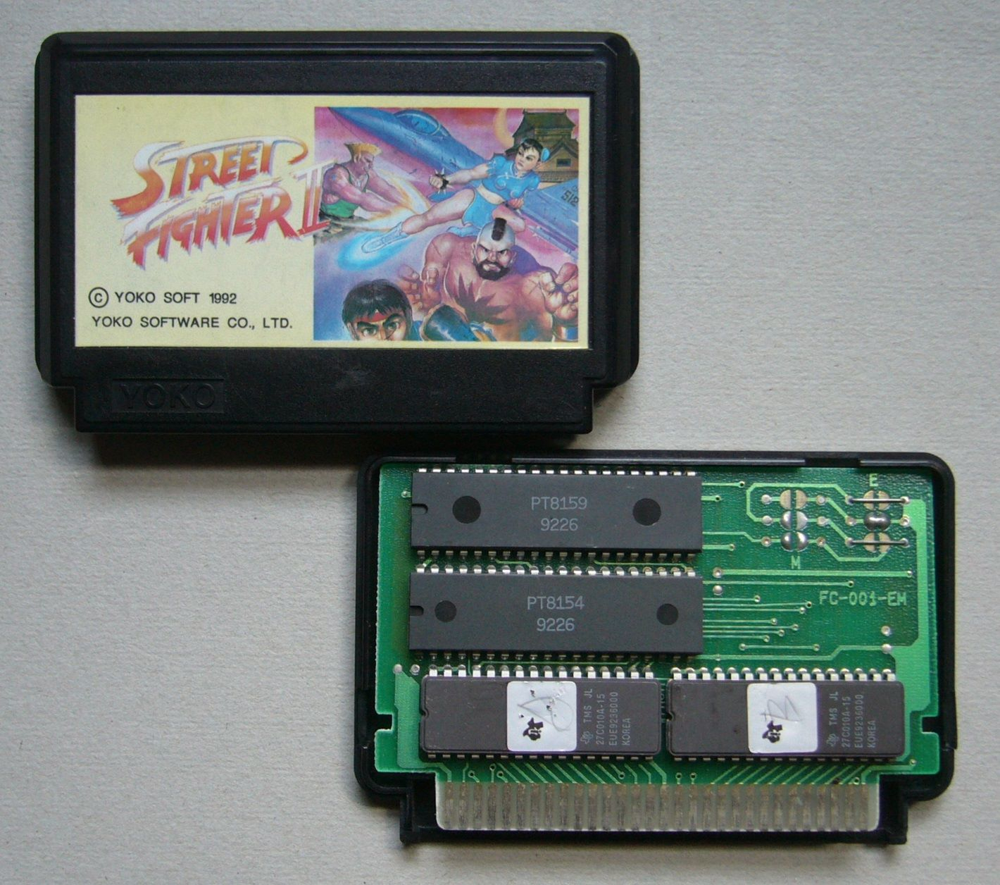

Version 2: PT8154 + PT8159 blobs (Street Fighter II)
PRG: 128 kB (CRC32=B0F32DEF)
CHR: 128 kB (CRC32=D1390DA0)
PRG register: $4100: [..PP....](mask: $E100)
Notes:
* Game writes to $4132
* Left blob (PT8154) is responsible for /IRQ and CHR banking. It has the pinout matching "regular" AX5202P MMC3 chip (except PRG-A and CHR-A17 lines, which are not present)
* Right blob (PT8159) is responsible for PRG banking and generating CHR-/CE = PPU-A13 or PPU-/RD. Its pinout is
    PRG A16 <-  | 01      |
    PRG A15 <-  | 02   19 | -- VCC
     CPU D4 ->  | 03   18 | <- PPU A13
     CPU D5 ->  | 04   17 | <- PPU /RD
     CPU D0 ->  | 05   16 | -> CHR /CE
     CPU D1 ->  | 06   15 | <- CPU R/W
     CPU D2 ->  | 07   14 | -- GND
     CPU D3 ->  | 08   13 | <- M2
CPU /ROMSEL <-  | 09   12 | <- CPU A8
    CPU A14 ->  | 10   11 | <- CPU A13
* D0-D3, despite being routed, does not seem to be responsible for anything (no, there is no OR-ing behaviour as stated here

Some comments: I have owned a few "Yoko"-branded copies of both Street & Master Fighter II and they were always like #2, never ever owned or known anyone that had a copy like #3.

Re: Street Fighter II (mapper 189) overview
Thank you, I will check them but despite using different chips, functionally it's probably the same like #1.
BTW. I talked to owner of http://glukvideo.info/ and he was able to supply bottom photo of Gluk Thunder Warrior. Now it is clear this is functionally the same as blob version and PT8154 is MMC3 without PRG and IRQ functionality.

Version 2:
UVEPROMs
PCB: FC-001-EMC on solder side, FC-001EMC on component side
