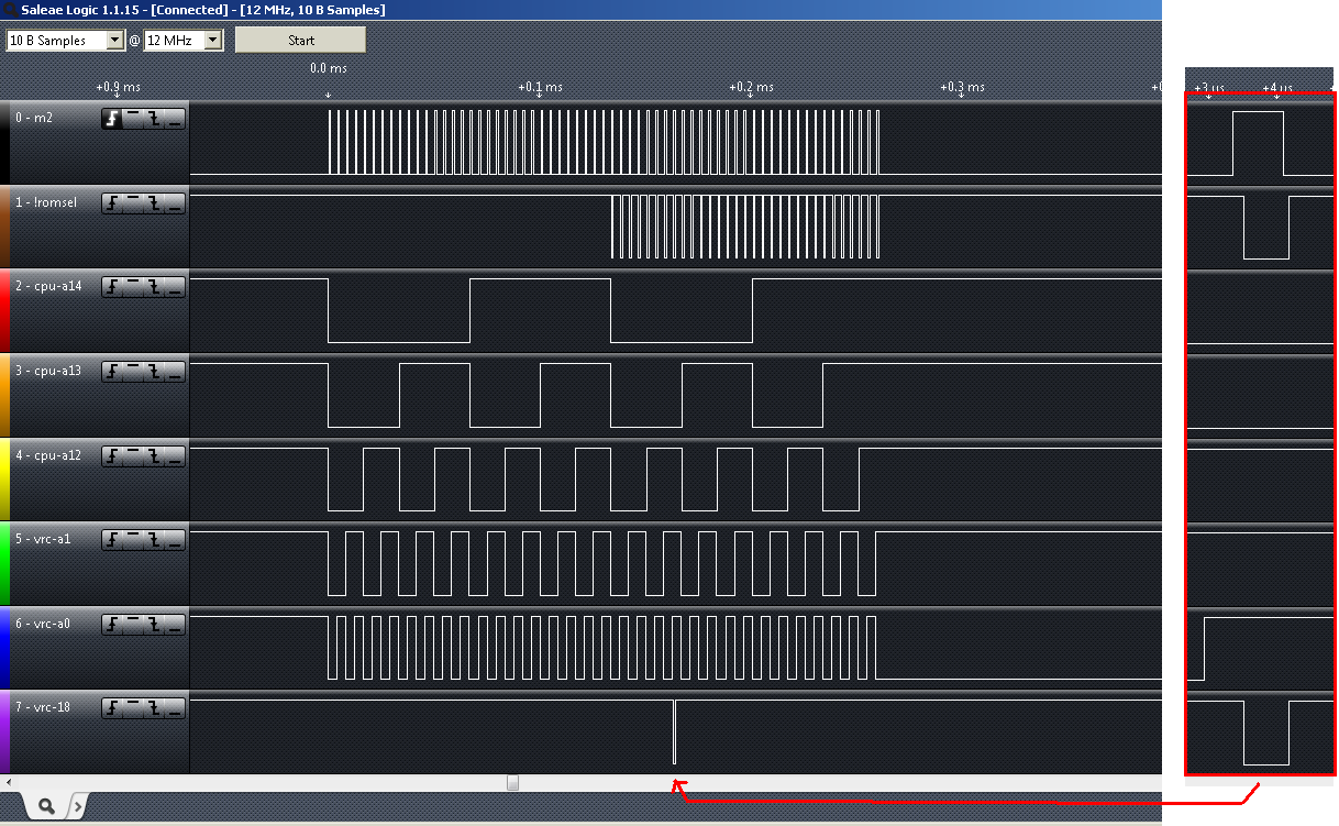

Accidentally, during fixing broken Gimmick VRC4 hack, named Suikan Pipe I did some testing to the AX5208C chip, which is pirate VRC4 with 1-1 pinout.
What i've found out is that:
* pin 16, which was meant to be CHR_A18 in original VRC4 is also present in this chip,
* pin 18, which was unknown, is some kind of output. For each of those different addresses, that VRC4 can recognize: $X00Y, where X={0, ..., $f}, Y={0, 1, 2, 3}
this pin is driven low only during write cycle to $9003
* PRG swap is only present at $9002, not also at $9003
Re: VRC IV pinout
Do we know whether those behaviors just happen to be present in the original VRC4 also?
Re: VRC IV pinout
I tested the original VRC4 at it behaves the same way as pirate AX5208C - both in having the special reg at $9003 and having the PRG swap reg only at $9002.
Also, the mirroring reg sits only at $9000.
Wonder what is at $9001.
(I tested the pirate VRC2 = 23C3662 and it seems to also have the mirroring reg only at $9000)
