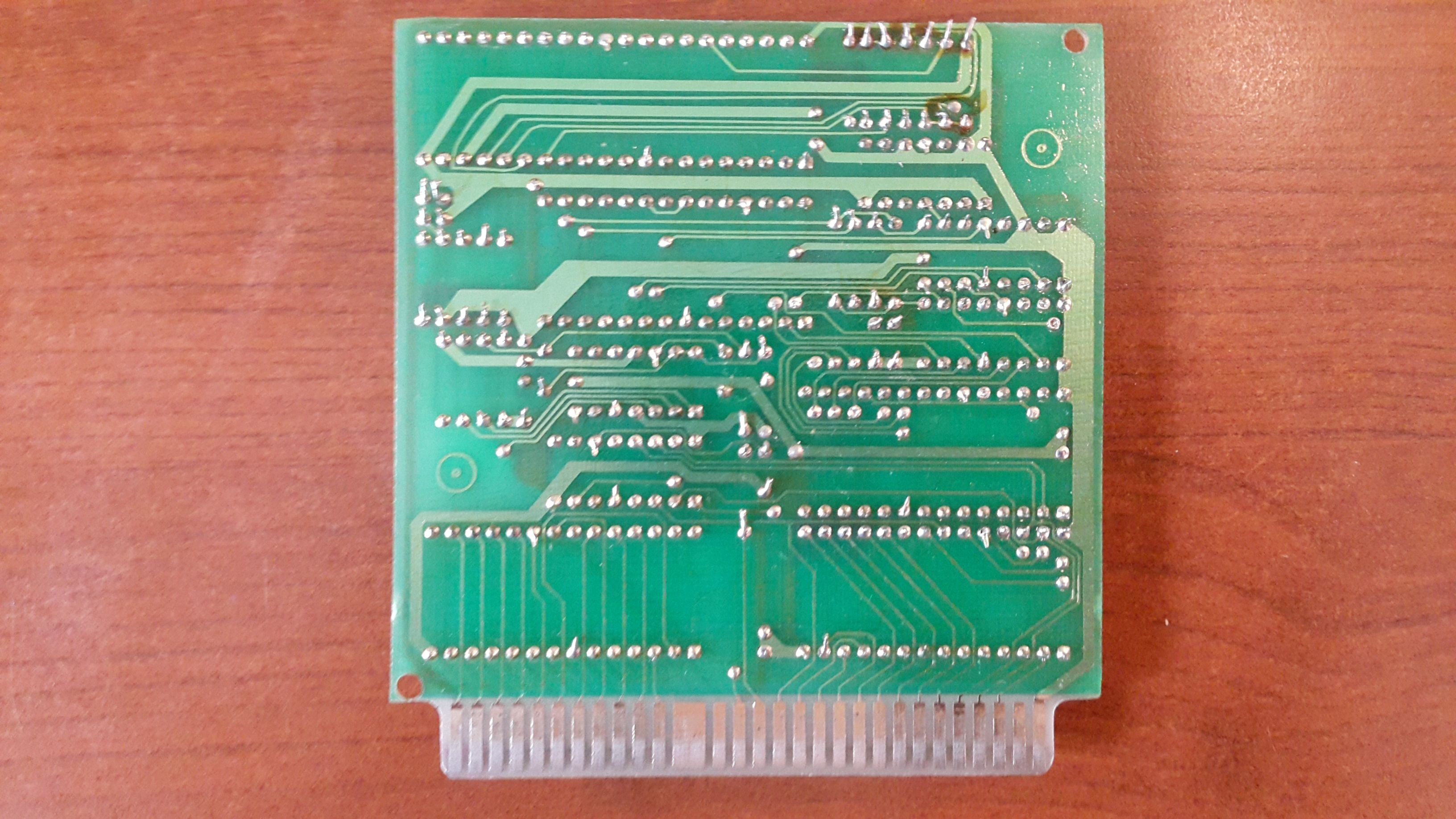

I got this bootleg - wonder what's the DIP40 chip with removed markings.
I rev'ed the schematics:
This `unknown` DIL40 chip seems to be UM5100 (voice processor) - pinout matches.
I attach dumped ROM3 with sounds - viewing in hexeditor shows that it containins 16 sound, separated by 0xAA bytes.
Yes! Long time ago I was playing with UM5100, I even built board for testing it (it can record samples to SRAM and play them back or play back samples from EPROM).
Putting EPROM from this cartridge proves that it is this chip!

Final schematics:

Re: Moero Pro Yakyuu voice
... Yup, as the datasheet says, that's definitely just DPCM. Sounds pretty bad, too :/
Per the datasheet, the sample clock is 1.35/R/C ... are you sure C9 is 2.2µF? The datasheet uses a 4.7nF capacitor there.
Interesting that they explicitly support two sample clocks via the bit at $5000.7. Looks like it shorts out R4 when low, making only R7 relevant for the sample clock; should be faster when high. This is probably a hysteretic inverter (74'14) as a clock source... usually that's a symmetric waveform, but D5 will make it more nearly a sawtooth generator. I think that doubles the effective frequency?
Arbitrarily assuming that it's 2.2nF, that means the sample rate should be ≈20kHz (2.7/62kΩ/2.2nF) when $5000.7 is low and ≈50kHz (2.7/2.2nF/(39k//62k)) when it's high.
... That's an X2 type capacitor for use in a mains voltage context. Probably is 2.2nF, but ... it's pretty darn funny seeing it there.
What's the mapper on this bootleg?
It's almost identical to the original hardware (i.e. mapper 86). The playback IC has been replaced with with this one, and the register at $5000 (controlling playback speed) has been added. The registers at $6000 and $7000 are unchanged.
