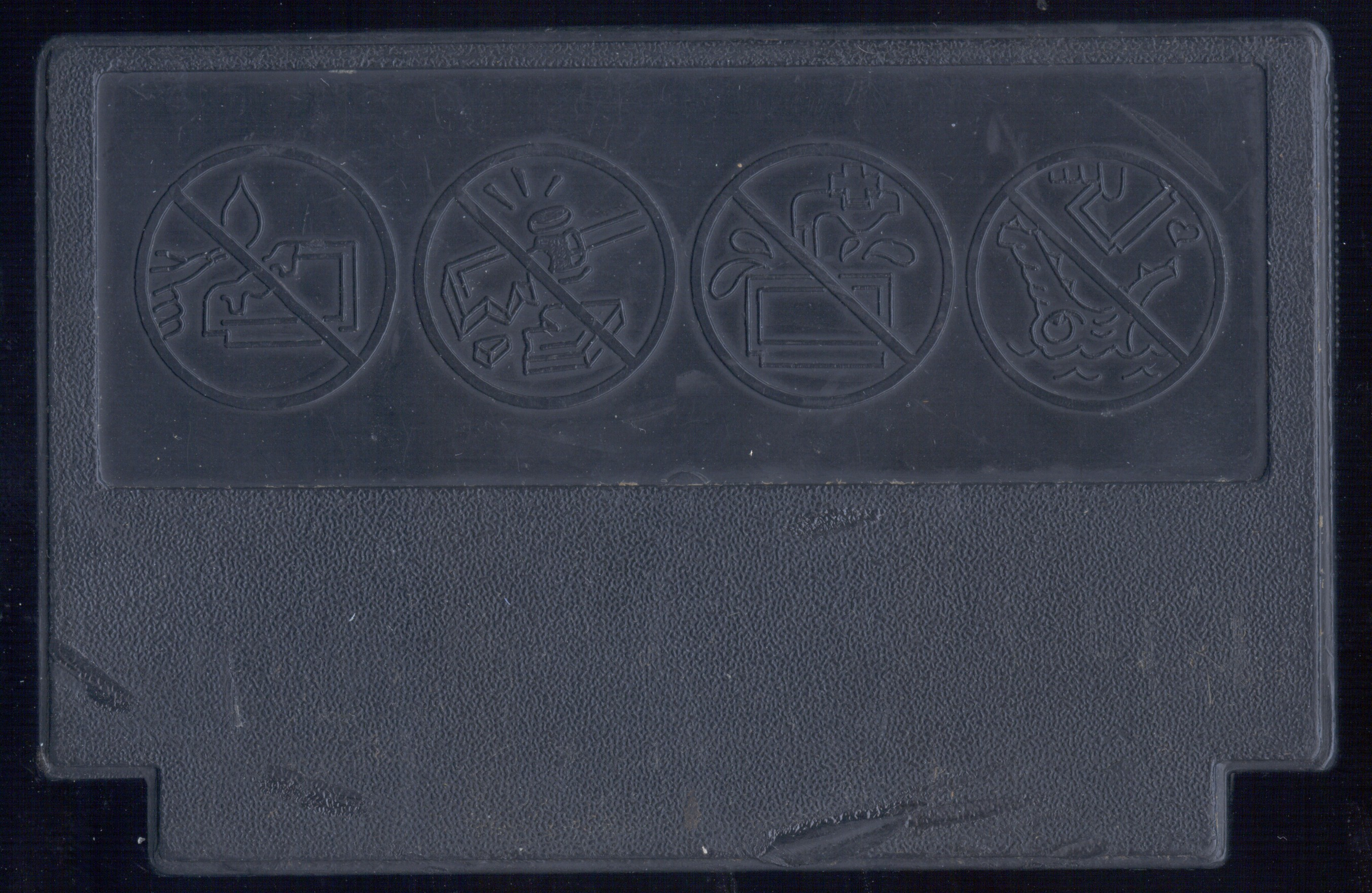

I finally was able to obtain one game with KS 204 Kaiser chip and analyze it.
The KS204 chip is nothing more but a Kaiser clone of Tengen MIMIC-1 MMC3 predessor (INES Mapper 206), known also as NTDEC 8701.
The only difference is lack of PRG/CE pin (instead, external RESET is present) and shuffled pinout.
