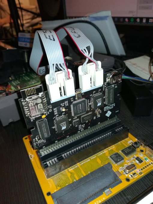

Hey everyone !
Been a long time since my last post here, but I didn't stop working on NES/WiFi/Internet stuff !
I gave up on the controller port version, and focused on a cartridge with a WiFi module on it.
And yesterday I finally played Pair the Pets (my first homebrew) with Roger Bidon (Super Tilt Bro.) through internet ! That was so cool !
Don't have much more to share for now since it's in its very early stage of development, but I'll let you know as soon as I have more to share (hopefully videos).
In the meantime, here are some tweets and pics ...
https://twitter.com/Broke_Studio/status ... 6409657345
https://twitter.com/Broke_Studio/status ... 0413877248
https://twitter.com/Broke_Studio/status ... 1874817024
My first game : Twin Dragons available at Broke Studio.

A new mapper has been added to FCEUX to quickly test roms. Mapper 3840 ($100), basically NROM + WiFi functionalities. Sylvain Gadrat aka Roger Bidon (Super Tilt Bro.'s dev) did most of it.
For now it matches my hardware implementation, but it's really basic and needs some more work.
To have something simple to offer and use, the end product would be as in the pictures I posted, a wifi chip on a cartridge.
Something like the blinking light win is a good idea but the end user would needs to open the console, and I really want to avoid that. I'll keep it in mind though, thanks :)

How do you pull power? By my calculations, any wifi board would pull far too much from the cart slot, requiring external power.
What's the bandwidth like?
That fceux branch has two implementations, and I'm not sure which one is actually used. A simpler UDP INLFirmware and then a http server with lots of trendy APIs under BrokeStudioFirmware.

Everything is powered by the console and work fine (I have to do some measurements one day or another though...).
Didn't measure the bandwidth yet, because that wasn't my priority, but we will arrange that.
