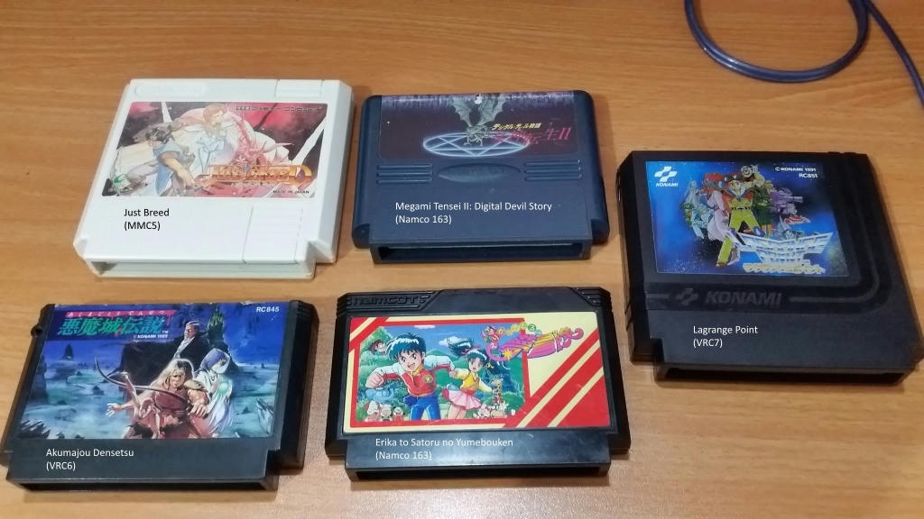

I have a HVC-CPU-07 and two AV Famicoms.
I also have Akumajou Denstsu (VRC6), Erika to Satoru (Namco 163), Megami Tensei II (Namco 163), Lagrange Point (VRC7), and Just Breed (MMC5).
I'll start with a AV modded HVC-CPU-07 through pin 46 (shielded cables and all) since all the expansion audio carts were made for it.
Measurement results:
Delta of RMS values without the initial peak on note start.
Famicom HVC-CPU-07 - db_apu: -0.03dB
Akumajou Densetsu - db_vrc6: -1.11db (expansion slightly quieter as it should).
Lagrange Point - db_vrc7: 10.88dB
Just Breed - db_mmc5: 0.05dB
Megami Tensei II - db_n163: 11.58dB
Erika to Satoru - db_n163: 18.16dB
