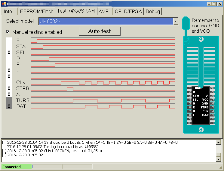

What software did you find/buy/write to explore the state machine of the BF9096?
Re: BF9096 (camerica mapper 232) - invalid pinout descriptio
Posted: Tue Dec 27, 2016 5:05 pm
by krzysiobal
It is a device + program made by my hands.
The device consists of DIL ZIF socket and Atmega 8 which communicate with PC through USB. 30 out of 32 pins (except bottom left and top right) are connected with Atmega pins (with serial resistors). Atemga can read/write signals on any of those pins. Serial resistors protect pins from overcurrent if there is different logic level on both sides.
The PC part is a control program written in C#. It basically allows doing following things:
* reading ROMs/EPROM/Flash
* programming flash
* automatic testing IC circuits (74xx, SRAMs, asics, pals, etc). The logic function of such device is hardcoded in PC application, so adding new device is just matter of minutes - add new class defining logic of outputs with respect to inputs.
* dumping PALs.
I succesfully restored PALS of 168-in-1 famiclone multicart, golden 5 (5-in-1) famiclone multicart.
Few days ago I aded useful function for manipulating the logic levels of pins just by clicking on them so it can be used for fast testing behaviour of some new chips.
