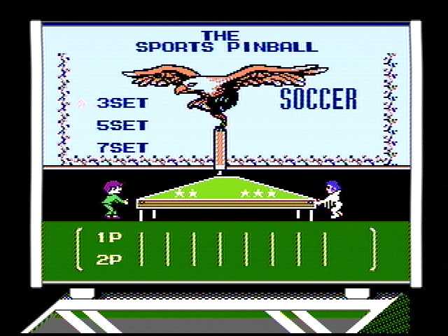

A little off-topic, but I wonder if this has ever been done before:
http://www.myabandonware.com/media/scre ... ball_7.jpg
A double-sided pinball machine.

The term of art for that form is known as a "head-to-head pinball" machine; examples include Gottlieb's Challenger in 1971 and Williams's Joust in 1983.

Jedi QuestMaster wrote:A double-sided pinball machine.
Man; in my mind, I had a gravity-defying pinball machine. :lol:
