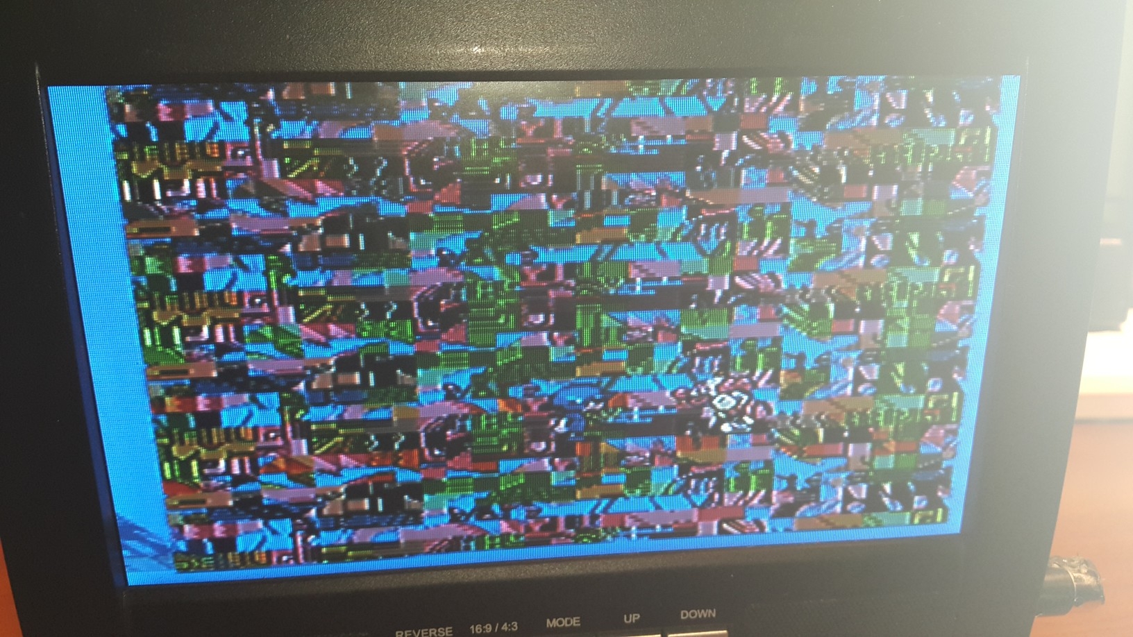

One man gave me NTSC NES to fix. The problem was that all games were running correctly, but instead of background - there was just random checkboard of tiles (sprites are displayed correctly). At first glance I thought that VRAM is broken, but no.. it is the PPU itself!
I replaced it with UA6528 and all works fine, but I kept that broken PPU for myself. Because I have not many NTSC PPUs in my collection -> I thought it would be good exercise to take closer look at the problem and maybe fix it.
So for all CHR-ROM games, it displays just random set of sprites:
But if it's CHR-RAM game, there is complete mess:

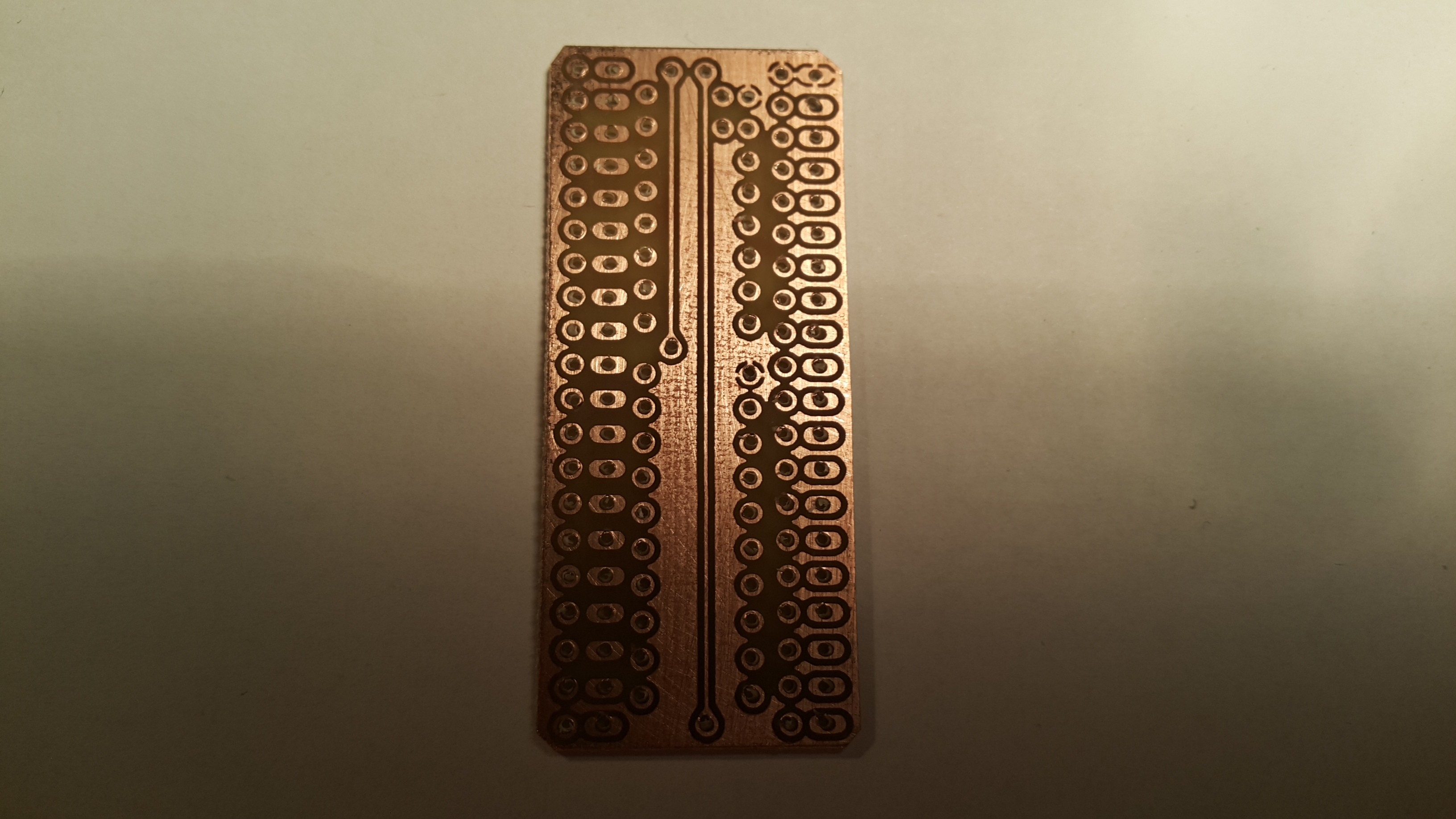

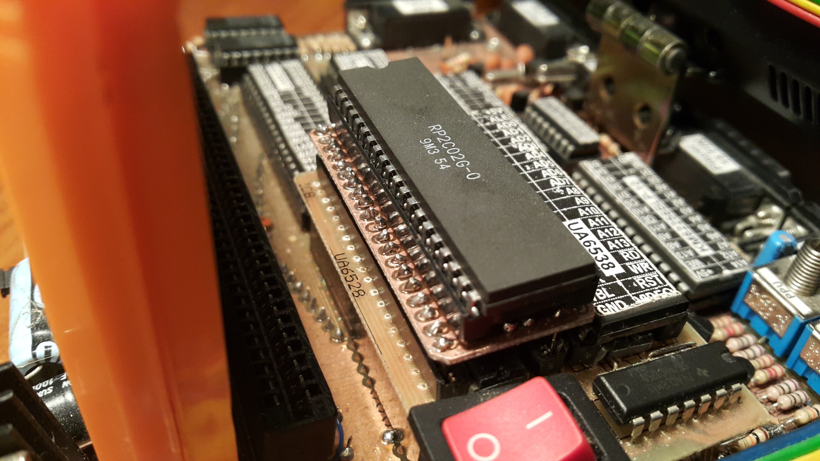

Haha, it works! I've projected the PCB as I described:
But then I changed my mind and replaced buffer with just 8x1k resistors, because I wanted everything to fit under broken PPU:
Image Image Image Image Image Image Image
I even left place for soldering deglitching cap and /WE delay, but just ommited them -> everything works perfect! Welcome to second life, mr PPU =)

Nicely done!

by thenendo
I’m in awe!
Have you tried any games with raster effects?
I wonder what kind of internal fault would cause this behavior by the PPU...

by krzysiobal
I tested it against:
RasterChromaLuma.NES
RasterTest1.NES
RasterTest2.NES
RasterTest3.NES
RasterTest3a.NES
RasterTest3b.NES
RasterTest3c.NES
RasterTest3d.NES
RasterTest3e.NES
and results are the same like on UA6528 (NTSC-clone PPU).
Sometimes when I load any of those demos, background is blinking black-white (as visible in attached video) but after restarting console, it is displayed correctly so maybe those demos are sensible for CPU/PPU cycle allignment.
Comparision video - First half - fixed RP2C02, second half: UA6528
