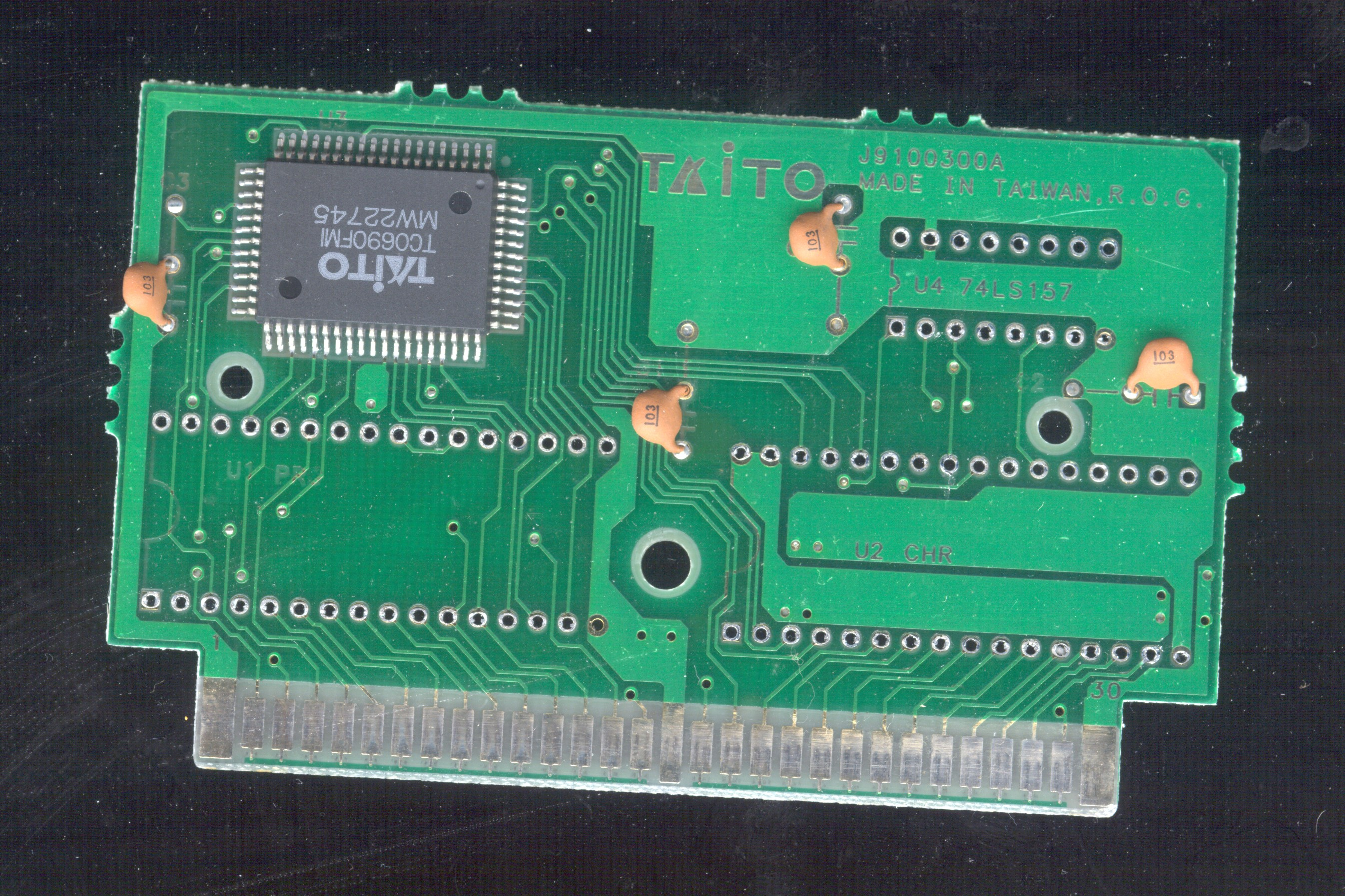

The only direct evidence we have so far is the picture Overload took of "The Flintstones: The Rescue of Dino & Hoppy"-
On this board ("J9100300A") there is also a 74LS157 wired up to serve as a transparent latch, where it holds copies of PPU A12 and PPU A13 ... I can't see all the signals but I think it's transparent while PPU/RD is high ... and these latched copies then go to the TC0690.

That reads like a circuit to prevent clocking the scanline counter when writing to $2006 mid-frame. Unfortunately, neither Flintstones not Jetsons do that (Flintstones at least not pre-IRQ), so it is unrelated.

Shouldn't that be the other way? It only holds the value (and rejects new ones) when PPU/RD is low. (I mean, assuming I'm guessing connectivity correctly)

If the passed-on value is the latched one during one state of PPU /RD and transparent during the other, either A12/A13 changes are not passed on to the chip during reads or during writes. Certainly, it will not be that only write-cycle A12/A13 are fed to the scanline counter, because that would render it inoperational.
Re: Taito TC0690 IRQs
Right, but I interpreted what you were saying to mean that it was there to keep raster effects (mid-render writes to $2006) from incorrectly clocking the counter...
If my assumption about the connectivity is correct, namely it only passes through values when it's not fetching from the PPU's bus, then any random $2006 writes would pass through and clock the counter unhelpfully.
If I'm misreading it, and it's only transparent during PPU reads, then yes that would keep writes to $2006 during blanking from incorrectly clocking the counter...

I am unsuccessfully trying to wrap my head around what exactly it means when you are only passing through values when the PPU is NOT reading, and what the purpose of such a thing would be. Unless the game is writing, won't the address that is then passed on just be what the PPU was reading from earlier? So is it basically just a delay?lidnariq wrote:If my assumption about the connectivity is correct, namely it only passes through values when it's not fetching from the PPU's bus
That is exactly where I'm getting stuck also.NewRisingSun wrote:and what the purpose of such a thing would be.
Writing vs not isn't relevant here... PPU /WR definitely does not proceed from the card edge.Unless the game is writing,
I'm not even convinced it's a delay? Beyond the standard 74LS TTL propagation delay, anyway. Which may have been accidentally enough for whatever they needed.So is it basically just a delay?
The only signals in the area at all are PPU/RD, CIRAM A10, and CHR banking outputs A12, A15, A16.

I bought original Flintstones to test the TC0690 chip.
On real hardware (NTSC console) Flintstones run fine. I swapped the EPROMs for the ones with pre-programmed Jetsons ROMs and there is the scanline artifact (see attached videos).
Flintstones: https://youtu.be/fdR8Reo8xFU
Jetsons: https://youtu.be/eQ64sxrECQI
The TC0690 pinout on this particular cartridge is following.
I was particulary curious about the huge amount of unconnected pins, so:
* 1, 2, 18, 19, 20, 31, 32, 33, 34, 39, 49, 50, 51, 52, 60, 63, 64 - no signs of any internal connection (multimeter diode test to GND/VCC)
* 5 - CHR A18 (because TC0690 does not ignore D0 unlike MMC3 when setting 2k CHR banks, it is possible to access 512kB CHR memory but only using 2k banks)
* 36 - PRG A18
IRQ seems to behave differently that in the MMC3:
* Mechanism of IRQS:
* IRQ is asserted immediatelly if IRQ_pending flag is set AND IRQs_are_enabled
* It is impossible to tell if the IRQ_counter is reloaded instantly when writing to C001 or when falling edge of PPU /RD (but that does not matter)
* Only writing to C001 clears the IRQ_pending flag (dislabling IRQs doesn't)
* IRQ counter reacts only when there is a PPU A12 transition at $0000-$1fff and only during PPU reads (because the external 74157 mux prevents chip from seeing actual PPU A12/A13 values during PPU write cycles)
* IRQ counter does not checks for M2 when determining if two A12 transitions are too close to each other
* 36 - PRG A18
