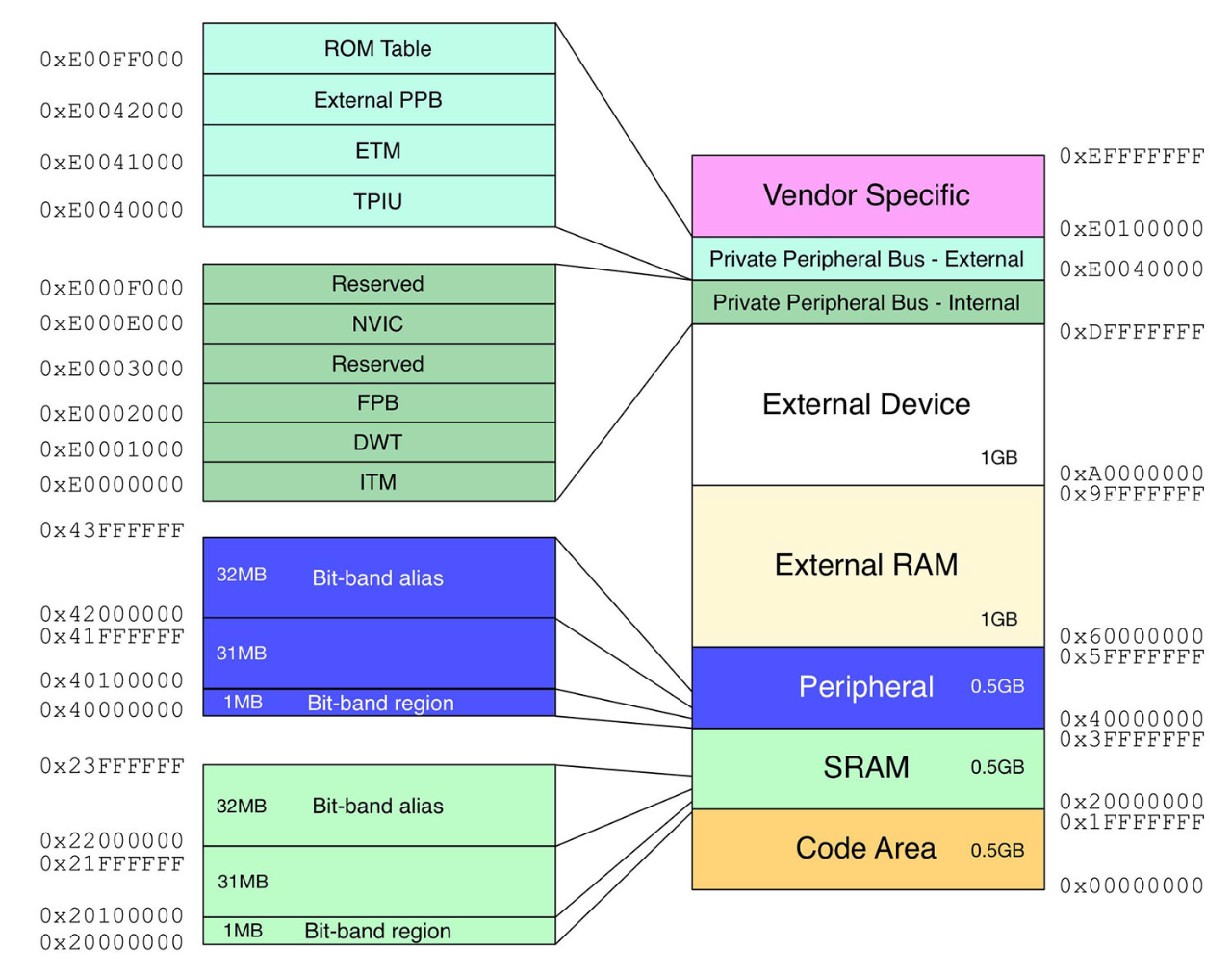

koitsu wrote:t's actually backwards (inverted) for starters, which is tremendously confusing ($FFFF should be at the top of the diagram and $0000 at the bottom, not the other way around).
How is that inverted? It's natural to have memory laid out in a reading order - $0000 is first in memory, so it's at the top. Otherwise, consistency would also require bank $00 to be at the far right, wouldn't it?

Some people like to document memory maps from top to bottom, others from bottom to top, I don't think that there's a "correct" way to do it. Doing it from bottom to top seems helpful to convey the concept of stacks, but other than that, I see little reason to not use top to bottom, as has everything ever been written in the history of mankind...

ISSOtm wrote:How is that inverted? It's natural to have memory laid out in a reading order - $0000 is first in memory, so it's at the top. Otherwise, consistency would also require bank $00 to be at the far right, wouldn't it?
No, it can be however someone wants it to be, apparently. I took the liberty of pulling tomes off my shelves and the conclusion is: it varies, and in one case the book isn't even consistent:
SNES developers manual: $FFFF top $0000 bottom, bank $FF on left $00 on right
Apple IIGS firmware reference: $FFFF top $0000 bottom, banks not visually depicted in diagrams
Apple IIGS hardware reference: $FFFF top $0000 bottom, however for bank, bank $00 on top $FF on bottom
GTE 65816 document: $FFFF top $0000 bottom (found by looking at MVN/MVP opcodes)
Programming the 65816, Including the 6502, 65C02, and 65802: $FFFF top $0000 bottom, bank $FF on left $00 on right
Programming the 6502: $0000 top $FFFF bottom (or rather, "0" top, "64K" bottom)
6502 Assembly Language Programming: no map, however author depicts visually memory offsets in routines as +0 top, +1 next, +2 next, etc...
6801, 68701, & 6802 Microcomputer Programming & Interfacing: $0000 top $FFFF bottom
Microcontrollers and Microcomputers: $0000 top $FFFF bottom
ARM Architecture Reference Manual: $FFFF top $0000 bottom
Sega Mark III / Master System reference manual: $FFFF top $0000 bottom
Sega Saturn Programmer Tutorial: 25A00000 top 25A7FFFF bottom
Sony PocketStation PDA Hardware Specification: 0x0A000000 top 0x00000000 bottom
PCI Express documentation (referring to BARs): $0000 top $FFFF bottom
SATA/AHCI documentation (HBA memory map, ABARs, FIS): $00 top $1100 bottom
TL;DR -- Do it whatever way you want, tepples.
