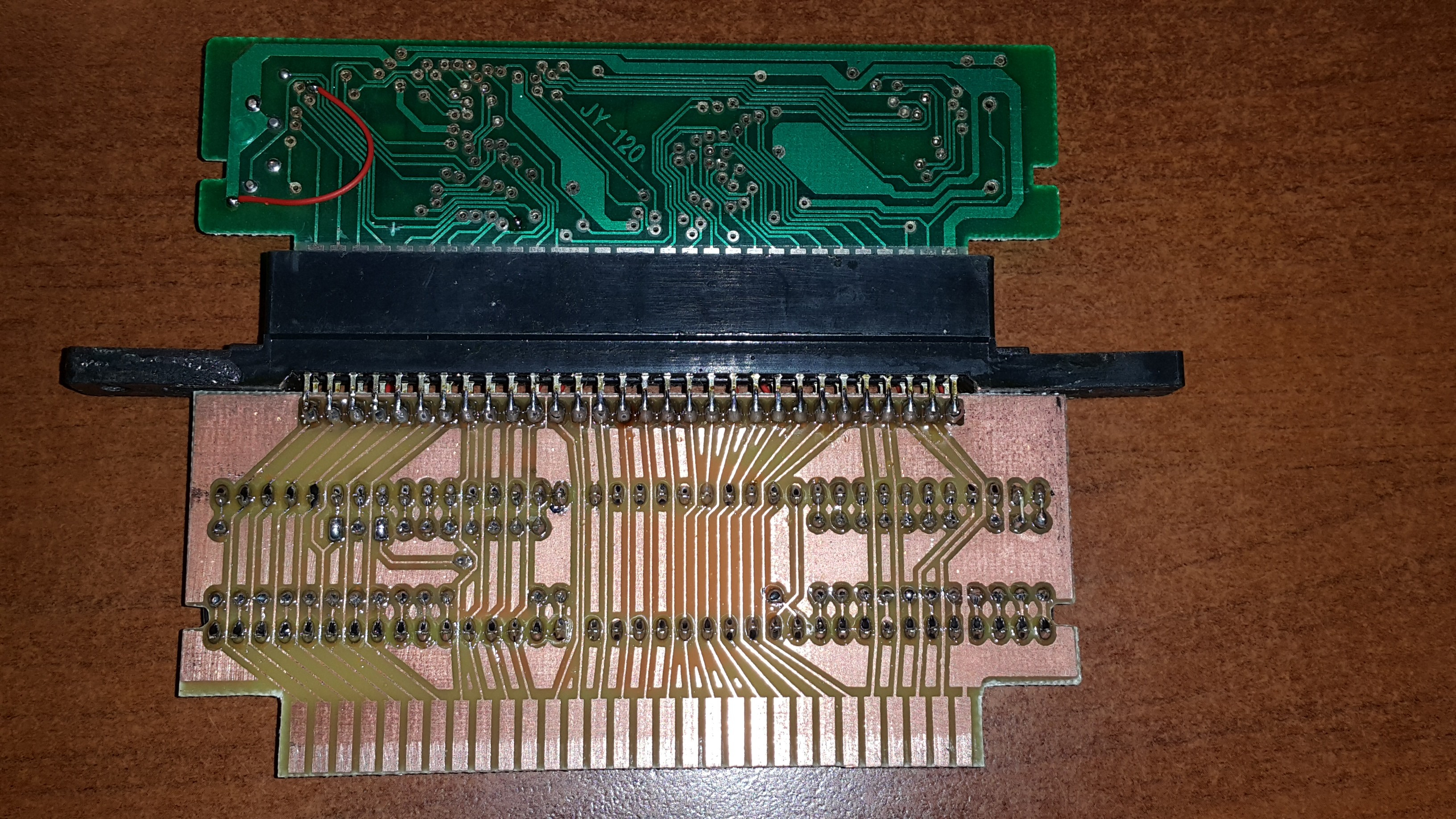

The solution was to project an add-on board that would:
* have cartridge connector that original JY-120 would plug in, allow to solder some wires and then plug everything into console (something like Game Genie),
* fit into original shell (luckily it is larger than normal)
* contain 2MB PRG-ROM
* contain FPGA to fix broken functionality of mapper if any is discovered.
Because of the over 1MB ROM chip, I had to use 27C322 EPROM. Believe me or not, but projecting the PCB to make every line go from edge to edge and also go to memory and FPGA was nightmare. And also I had to do it in that way so ROM chip is only soldered from bottom side, otherwise I wouldn't be able to desolder it without damaging PCB (that's why there are a lot of vias)
I had to shuffle data and address pins to make the layout as simple as possible.
It did not work from first run (I had to desolder the ROM chip 3 times and reprogram it cause of my mistakes and also poor documentation of this ROM), but finally I was able to make game boot!
https://www.youtube.com/watch?v=BYLg17ARHOY
Unfortunately there were some artifacts - probably because CHR-ROM was also broken. Fortunately I found out that I am able to control CHR-A19 and also CHR-ROM enabling at $2000-$3fff is not a bug (will describe that later). So this add-on PCB is useless and I had to project and make second one - containing PRG-ROM and CHR-ROM (FPGA for mapper seemed to be unnecessary).
Luckily this time everything worked!

$C005 <- $02 //counter
$C004 <- $05 //prescaler
$C001 <- %ab000110
$C001 <- %cd000010
$C001 <- %10000010
//#number of reads
 \ab 00   01   10   11
cd\
00 $206 $307 $105 $107
01 $306 $307 $105 $107
10 $106 $107 $106 $107
11 $106 $107 $106 $107
Despite what kevtris wrote and what I found in the Dish mapper docs, I am unable to:
* force $c007 to have any effect for the FunkyMode or anything else,
* clock the counter when in Funky Mode (even if $c007=$ff)
NewRisingSun
Posts: 1312
Joined: Thu May 19, 2005 11:30 am
Re: [fixing + analysis] JY-120 45-in-1
Post by NewRisingSun »
D003 D1/D2: The swapping of PRG A19 and A20 is the case for all sufficiently-sized multicarts that use the J.Y. ASIC. Correcting this would invalidate every dump and emulator. I think the mapper description needs to stay the way it is, only adding a remark that from the point of view of the mapper chip, the bit order is different.
The D003 D5 description is strange; the expected behavior would be that D5=1 permits 512 KiB of CHR-ROM being selected with $9000-$AFFF. All games (and single games on multicarts) that use 512 KiB of CHR-ROM (none of which are on JY-120A) set this bit, and all that use less than 512 KiB of CHR-ROM clear it, no exceptions.
As for the IRQ description: From what I understand (and correct me if I am wrong), the current wiki description is almost correct except that it does not account for the fact that the registers must be written in the correct order to function as described.
As I understand the funky mode description, it basically decouples the counter from the prescaler, allowing the prescaler alone to generate IRQs provided that the counter is set to the correct value according to the counting direction?
