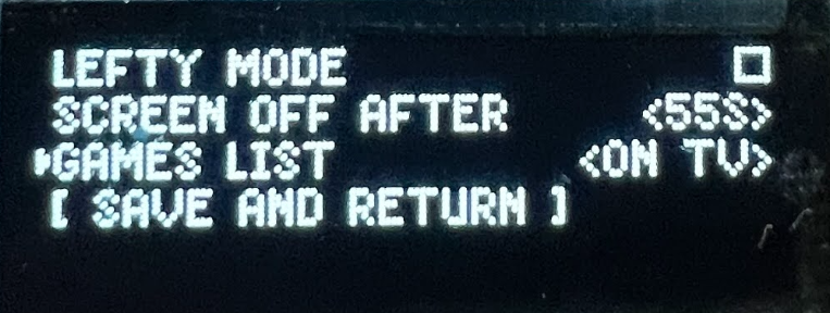

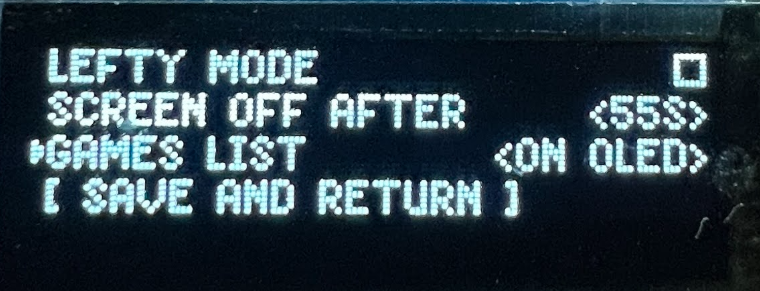

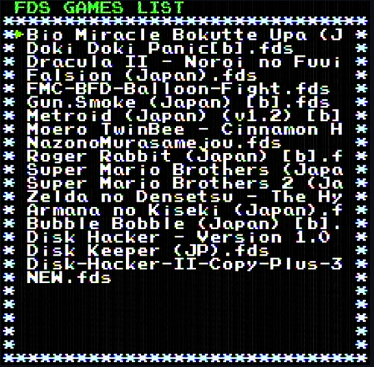

Just a small upgrade to make FDSKey more interesting
:beer: :beer:
https://youtu.be/ZjAdUov6Ob8

Ah, so it's been made to behave more like the FDSEmu/FDSStick. I can see this being useful for setups where the FDSKey is not easily accessible. The need to flip disk sides is still a problem, though.

TakuikaNinja wrote: Thu Oct 16, 2025 4:28 pm Ah, so it's been made to behave more like the FDSEmu/FDSStick. I can see this being useful for setups where the FDSKey is not easily accessible. The need to flip disk sides is still a problem, though.
Yes, you got it, :beer: . Still no idea for disk flipping

The main appeal for me with the FDSKey is the OLED which allows to select disk without loading a menu program into the RAM adapter for selecting it on the TV, which sacrifices accuracy. But if this menu loading is an optional feature it's fine I guess.
The auto-swap of the Everdrive is the worst feature it has IMHO, you can't even watch the intro in Doki Doki. I want to be in full control of any and all disk swaps at all times, so a button is best.
