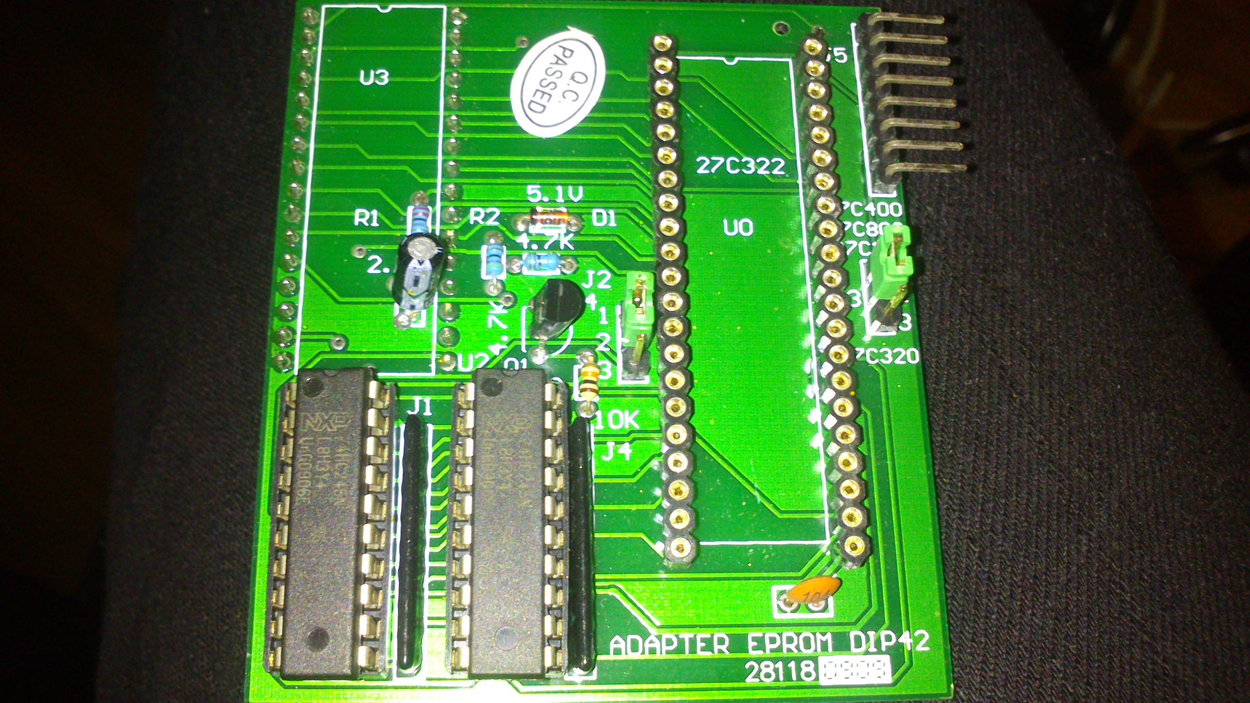

Hey there,
I bought an 16bit adapter but I'm not sure how to cennect it to my willem. Maybe you guys have a clue:
Below U3 are the pins which are locked into the ZIF socket.
http://www.jensma.de/upload/files/XQDQS ... C_0457.jpg
This is the adapter:
http://www.jensma.de/upload/files/AY2G7 ... C_0466.jpg
This is the connector where the adapter is connected to the willem with a cable:
http://www.jensma.de/upload/files/o0hmV ... C_0458.jpg
The backsite of the adapter:
http://www.jensma.de/upload/files/SldSZ ... C_0469.jpg
These are the pins where the cable of the adapter will be connected to. I have no clue which way it should go in:
http://www.jensma.de/upload/files/PTl1Q ... C_0465.jpg
PS: Does anybody know what this "J2"-Jumper on the adapter is for?
Any help is much appreciated ;)

On my 16-bit adapter the four lines that are relevant are labeled on the 16-bit adapter PCB, allowing me to fabricate an appropriate cable. In your case, just trace the cable you have been given and see which lines match up to which spots... A19 on the adapter goes to A19 on the willem, etc. etc.

Thanks for the hint!
I made a quick diagram:
http://www.jensma.de/upload/files/2wl52 ... titled.PNG
I'll try to connect the cable an write the eprom - if it fails, I'll just swap it around and see if it works :) Thanks!

Why are you using a 16 bit device? Don't you need an eight bit rom? I am not familiar with dragon quest cartridge. What is the cart I.D? 1A3M??

I just looked up what type of cartridge is used. It's a 1J3M. - a common hi rom cart.
You'd be slightly crazy to try to put a 16 bit 27c322 42 pin EPROM in this.
As previous posts have recommended, the Tsop adapter from buyicnow is the way to go.
You send them the file you want programmed, they'll program it and all you have to do is remove the mask rom and solder in the Tsop adapter you get from them.
